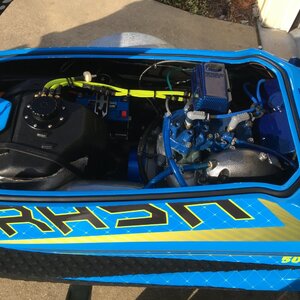

IMG_5278.JPG The 50cal has a perfect place to mount the Ebox. I used 2 Long bolts on the side then 2-2inch pvc pipe couplers behind the ebox to keep it up high. I know you have the notch in yours but you can just mount it down a little lower.
After about 10hrs on the 50cal surf layup I must say it's one of the funniest skis to ride. It's so stable and just knifes thru the chop! On the other hand as so as you want to slash or throw the ski around it acts just like an FX1 IMO. It rides so flat Yet will jump up out the water when you tell it 2. You use a lot less energy fighting to balance the ski yet it's just so flickable. Getting in that big tray is nice also . You can just pull the ski right under you the start it and go. No need to hold on while running to pull yourself up. I am all about saving all my energy for ridding.

View attachment 323923 The 50cal has a perfect place to mount the Ebox. I used 2 Long bolts on the side then 2-2inch pvc pipe couplers behind the ebox to keep it up high. I know you have the notch in yours but you can just mount it down a little lower.
Would it be possible that the heavier surf layup is what makes the ski glide through the chop easier?
