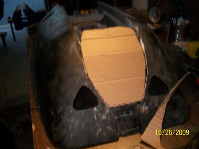

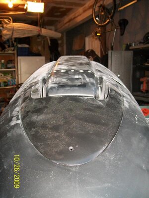

Did another cut today. Trying to lower the bars end of the pole. This dropped it maybe an inch.
Traced out a cardboard stencil and taped it on. Gonna glass over that, pop it off, glass it back on, and touch it up with some filler. The extinguisher cavity is staying, don't think the extinguisher will go in it, but I'm too lazy to cut it out and glass over it.
Somebody really needs to take my sawzall away from me.....
Third picture really shows how low it sits now best.
