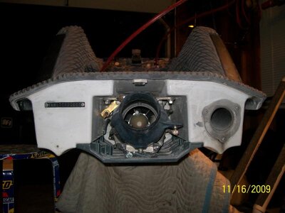

Anyway, I got a lot done today. Both sides are reinforced as well as the pole bracket area. Everythings masked off in the engine compartment and it's going all white tomorrow.
I cut the rear flange off one side. Gonna do the other tomorrow. Not really sure why I did this. Mostly because I was bored and I like to cut stuff up. I have trim but it worked fine with the tray just notched. I think it looks cool though. If any body knows what the purpose of doing this is please let me know, until then I'll put it under the category of "weight savings"

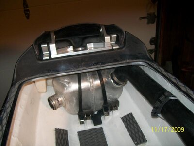

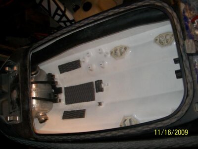

Got some more done today. Painted the engine bay. Installed all the tank and waterbox hooks and pads. Started some assembly. Made a hoodseal out of turf. Can't afford an OEM one at the moment and I talked to a guy who did this and he said it worked great. Rear flange is completely trimmed.

how did the wdk pole bracket work out for ya? It looks like a nice piece
It's very nice. Dosen't pop out above the nosepiece at all and is super beefy. I'll actually be proud of myself if I manage to ever break it. Ordering some pinch bolts for it this week from either X-metal or RRP and making a backing plate that will cover the entire area on the underside the bracket covers up top. I don't feel like the stock backing plates are big enough.

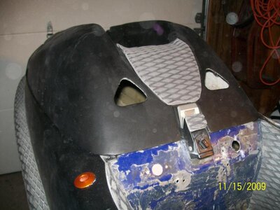

Weighed the hood today. 14.1 pounds. This was with the liner. handcups glassed in and all the hardware attached. No baffles yet, but I'm using pool baffles and they don't weigh much. I weighed the liner twice since it's getting a second layer, so this number may be off a few ounces
ehhhhh... Not bad I guess. It was 17.5 with the old mods. Not sure how much a stocker ways from the factory. Seems pretty strong. I have some pics of the liner and handcups somewhere, I'll get them up soon.
