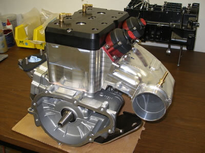

I love my Xscream 865SS (846cc), I let Xscream build the motor & do the set up/install since I run avgas in my Ski's. My motor rips, Like Idok posted he has rode a few SS motors & you can tell who let the Xscream crew to the complete package.
Stock pump, TBM & 14/19 works fine, but for the surf the mag pump is the only way to go.
I sent them a set of very nice 62T cases & very clean used crank. Which was used for my build. I think one bearing on the crank was replaced. If you got nice cases I think your going to be fine.
My new motor I order is a XS1000, B pipe, MSD Enh, TBM, Dual 46's, Billet Setback mag 148. (TC surf package) Reason for me was the cost, its not that much more to build a 1000cc motor so why not.
