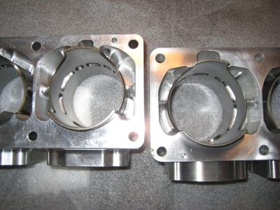

How come the DASA cases are not compatible? Do they only work with DASA cylinders? Is a DASA motor a chit load more expensive than a TS?
OCD Solutions
Rentz, GA
Transfer port mapping is different...DASA on the left, TS on the right.
