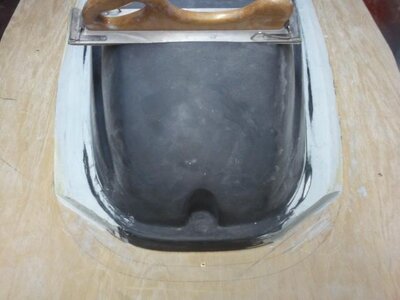

you can see the black under the bondo is the original rail. it is 2 inches wide and 2 inches on the angle down
