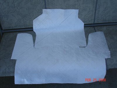

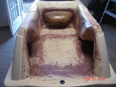

I fiberglassed the tray and footholds today. I used on big piece of 1708 and a bunch of 1 inch and 3 inch 8oz tape.

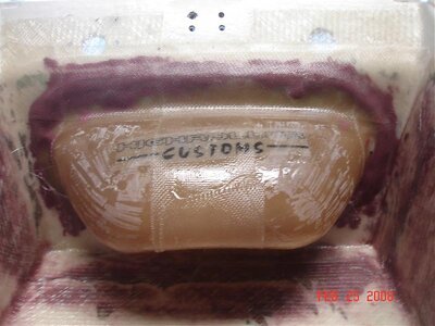

Here are the final pics with the epoxy still wet. I put one piece of 1708 behind the front foothold, screwed the foothold on with ss screws, and fiberglassed with the tape over the edges. I used epoxy/cabosil/microballoons mixture to seal off the tray and to fill any voids before I started since I was out of foam. I hope it works OK.
Everything was laid up together so it should be good and strong, maybe even overkill with the 1708. I'm so glad this part is over. I'm dreading the turfing but then it's just assembly. I'm sick of this and ready to ride. All day every day I'm off is getting really old.

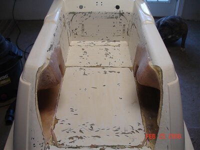

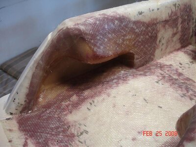

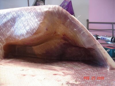

I filled the bondline with a mixture of 3:1 epoxy, cabosil, and microballoons. I went ahead and filled the entire bondline and the areas around the bulkhead. 1708 fiberglass on the sides, nose, and the area behind the ebox. I figured I would reinforce the nose some after seeing all the Daytona carnage. I put a layer behind the ebox to reinforce the hood latch and the front foothold I'm installing. I sealed around the bulkhead with the microballoon mixture and used 1 inch tape. I wanted a good seal to make sure my foam stays dry.
The last pic is every medium clamp, chip clip, clothes pin, and any other clip I could find plus some from my father in law and another neighbor. The 1708 wouldn't stick to the hood lip without a little help.
As you can see I didn't put any color in the epoxy. I was going to use black, but I decided to paint the whole engine compartment with white gelcoat instead.
I did all the stuff in the last three posts yesterday. I started at 8:30 AM and finished at 5:00 PM. My wife is really starting to get pissy about the time I'm spending on this. I keep telling her that I just want it done before spring.
when you do the engine compartment you can only do one side at a time and have the ski tilted on the side you are doing so you have a flat surface. aka you arnt working against gravity (it always wins) .no chip clips required..and when you do the nose you put the ski strait up and down on the nose..and you could do the same for the back if you reinforce the bulkhead

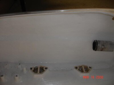

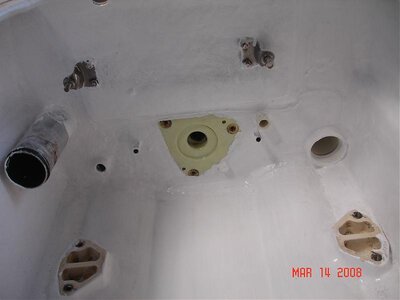

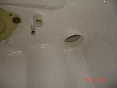

Here is the inside of the hull with the gelcoat.

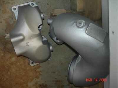

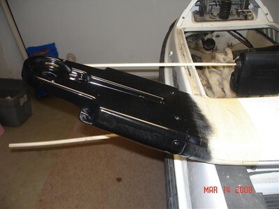

I sanded and cleaned my pipe today. I painted the whole thing with the 1200 degree high heat silver paint. I tried the black on the headpipe and exhaust manifold first, but it was too flat and showed my handprints.
I sanded, primed, sanded, primed and painted the metal parts of my pole and the turnplate. I used a gloss black for those parts.
