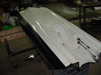

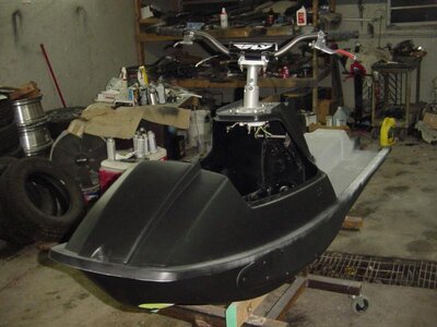

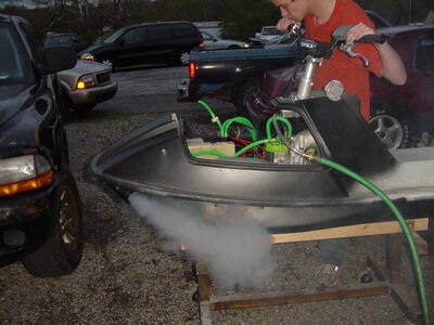

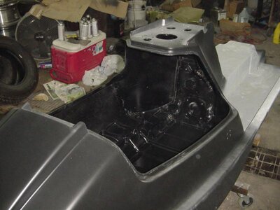

Pictures really don't do it justice. Paint was meant to be a "Rat-rod" ski and not be pretty, but it turned out pretty. haha. I'm building this ski solely for ripping, not looking good. Thats why I chose flat black. The camera didn't really get the best pics, so it doesn't look as good as it really is. For some reason it looks like there are spots on the paint, guess it was just water/moisture on the camera lens. This picture is after about 4-5 coats of paint, and 4-5 coats of low-luster clear. FLAT. Bling, bling.

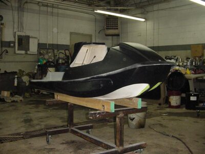

and below the progress continues :brap:
a lot has gone on in just a few days
this was nothing but a solid hull and a bunch
of boxes full of parts just a couple days ago
that chickenbone is a sneaky sob :scared:

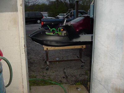

Man that looks good. Off to the shop once again, more wrenching. I think I ought to be able to fire this baby up tonight.

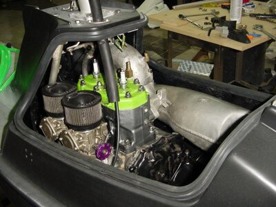

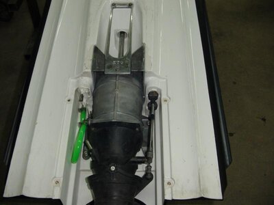

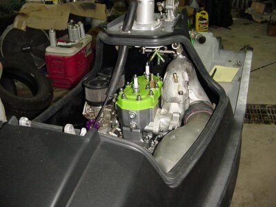

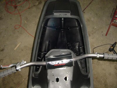

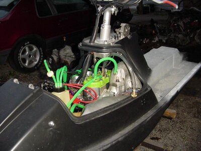

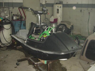

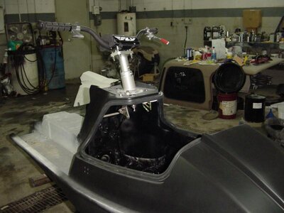

Well I tried fitting a second left side support, so I would have two of the deeper ones. After bending it up a little I got it to fit in, but then my steering hit it. So I just tried the stock right side, and it fit. The picture we put in was all a dry fit to make sure it was ready to start assembly, and as of then it bolted in with about a 1/2" of clearence to the support. It was tight.

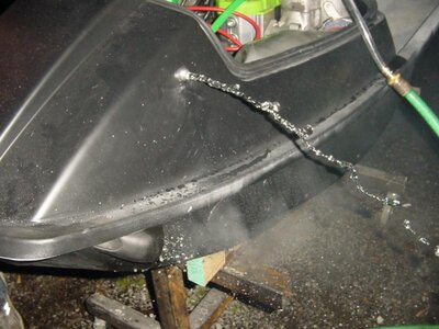

Wish I had better news my friend!! Got the ski completely together last night. Had all kinds of little obstacles to overcome, as anyone who as ever tried fitting dual carbs and a b-pipe in an X2 with tubbies already knows. PITA. Anyway, got it all done, at the last minute the brass water fitting going into my headpipe snapped off. ARHGHGHHH!! All that, to have it killed. Anyway, I had some other issues. Didn't think about having to run a restricting jet in the return lines on these buckshot carbs. Engine just ran off when I fired it after the shot I put in the carbs went. Once it was burning the fuel from the tank it would just run off. After thinking it over we realized, no return line restriction.. I'm thinking that would starve these carbs QUICK. So I'm heading back now to try and get the water fitting out and replaced, and T the return lines into the smallest main jet I have, think it's a 77.5. Hopefully that will make a difference. If not, out comes the engine. Overall with all the little things I had to mod and figure out, I'm not too upset that I'm having a FEW problems. Although I couldn't sleep thinking about that engine winding out. But it sounded GREAT while doing it. haha.
Back to it once again. Wish me luck!
hhh
We got BRAP!!!!!!!!!
