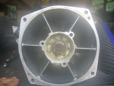

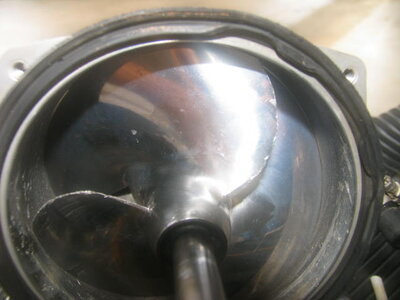

ok got my pump and nossle off.. i dident "see" anyhitn unusual, but dont really know what i'm looking for there... i can still spin the prop w/o the shaft spinning?
i tryed agen with the starter and nothign has changed with the pump out:17:
i'll get some pic of teh pump.. in a few mins
so now what?:banghead: :cussing:

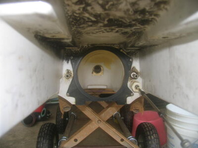

pluges are still out, pump is removed, look at pics... and i can not rotate it by hand all the way around..
i'll take the flywheel off next...

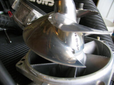

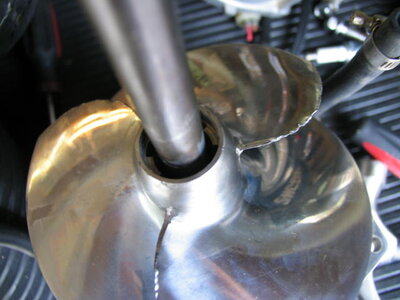

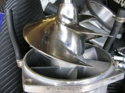

DAG
Charlotte, NC
still dont know why my prop spins freely????
is something missing???

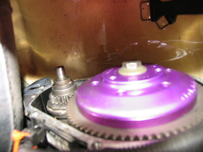

DAG
Charlotte, NC
ok removed the cover and the flywheel looked good.. teh bendix appeared good, however it was sitting in there somewhat wobbley.. is it suposted to be loose? the flywhee itself is on tight.

and i have a manual on the CD.. and yes i haev checked it quite a few times b4 i go wrenching.. b/c i haev never taken this thing apart... but i'm not worried about getting it back together... just WTF is wrong and how much is it gonna cost meh...
anyone know WTF is up with my prop? i'll get a viideo
