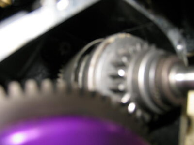

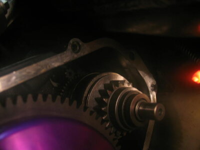

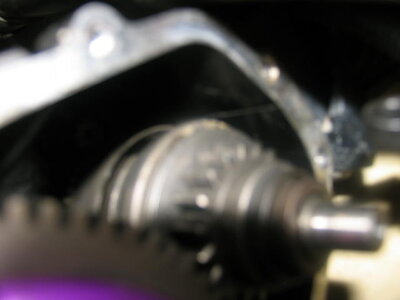

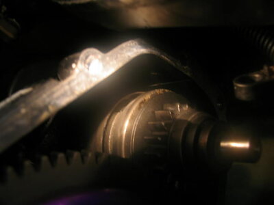

ok pulled the tank and got some shots of the bendix..
it looks as if the bendix itself is comeing apart.
i tryed to get the pics when the bendix was all the way forward. and i got some when they are all the way back.
just to see all teh movement, which is not much,
but there is deff nothing broken loose on teh outside.. but maby the thing is tore up inside preventing it to release back into the cover

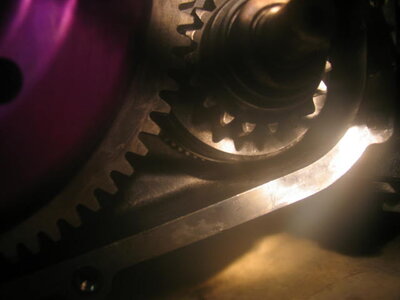

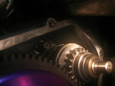

and some more

yeah dude, it seems as if you have a bendix/flywheel cocklocked issue.
Im reasonably sure ive seen that before in this thread.
:biggthumpup:
