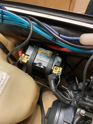

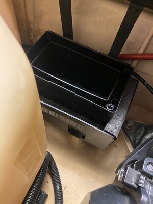

I am very happy with the set up. Only garage start ups so far so no real water experience but the doubled CCA is noticeable in the garage. I went from an odyssey Extreme PC 625 to a NOCO NLP14. I dropped a little over 10lbs as well.
