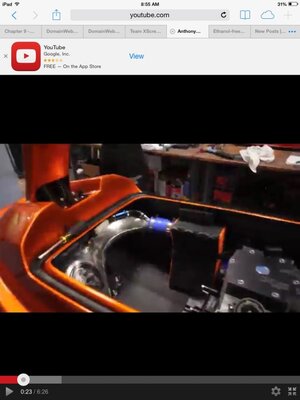

In my ski with 1 1/2 inch of padding below water box and sitting on my former battery perch mounting plate it let's water backup into the engine real easy, the water box is not baffled and it's real small, the elevation difference between the boxes inlet and outlet is nil. Gonna try and raise the water box 2 to 4 more inches and use a pre molded curved hoses and bent tube on its outlet to try and mitigate the issue. Can't go in surf right now with this thing. Can't deep water board the ski without first starting the engine, gotta leave engine on when loading onto trailer. I talked to one team and they have this issue too and another guy doesn't, his set up is the same layout as mine via photos he sent me.

Bummer guys are having water intrusion issues. Harbor hit me up on mine and I sent him some pics. When I deep water start, I fire it and side mount. It's nearly impossible to mount her from the rear, as she's small and tipsy lmao! Plus IMO side mounting is much faster when in rough water, or any water for that matter. Honestly I've had zero issues with water getting back to the motor.

I took another look at my set up, Ive also looked at the water line on the outside ski while its floating and translated that to the interior. Looked at pfp power box, xcreams tall box for the pfp. These two boxes I like because their is more distance between the inlet and outlet specially the Exceam but have been told these boxes are baffled not open like the RRP.
After these response today I looked again. @badvinny your box looks mounted higher in the hull than mine while @NVJAY775 is low mounted like mine.

image.jpg This white ruler represents the top of my bond line and the water line is touching the bottom of the bond line while the ski floats in calm water. 70% of my exhaust tube exisiting the water box is below the water line. The water box is 60% below the water line and the stinger is 30% below the water line.
This I suspect allows water to be in the bottom of my pipe which is not an issue until the noise is raised and tray lowerd on an engine off deep water rear mount or raising the noise to trailer it.
In the surf I'd be screwed!
So the first plan is to raise the box and the stinger 2+ inches and re-test.
