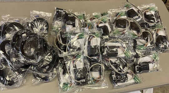

The second batch of the Y62T has arrived!

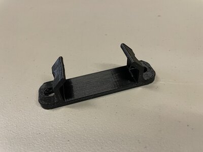

Im now offering an aftermarket mounting bracket to fit both the Y62T and the A02T zeel CDI
bracket is 3D printed and sells for $10. This makes for a really nice Sano install.
Y62T CDI $365.00
bracket $10.00
programing cable $65
custom tunes $25 each
USPS Priority mail shipping $10.00

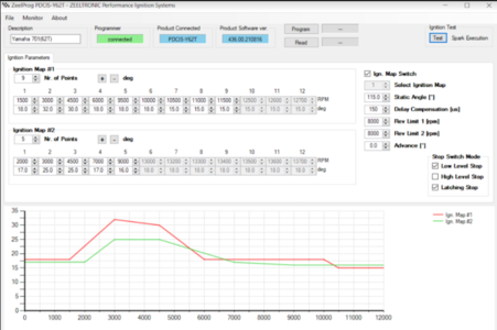

I have a question about this curve and how it works within the Zeel Programming. And maybe this has been addressed before and if I missed it, sorry.
In table and graph below, we see that the at 1500rpm timing is set to 18° BTDC, then at 3000rpm timing is set to 32°BTDC.
Does the timing change like the graph suggests? i.e. where at 2500rpm timing would be aprox 27.5°BTDC?
Or does it "wait" until you reach 3000rpm to "jump" from 18° to 32°

It follows the curve as a steady climb. You can add points to change the slope.
