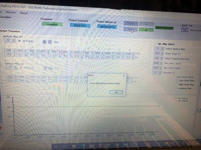

Those settings are just the blank screen

Trying to read what’s programmed into it so I can make some changes

Static angle should be 115 for a start , the software does not allow you to go this high,
you are out ide the table dimensions on this field
Those settings on the screenshot were not entered by me
its what comes up on the screen when first opening the software
I have installed and programmed quite a few of these , but was getting the error message when clicking on read this time
With a previous zeel install , I got the error message while programming , and it turned out that the start stop harnesses were unplugged. at the time. After Plugging in the stop / strat harnesses I was able to connect and program it.
on this occasion , with this zeel , it turned out that I had missed connecting one of the ground ring terminals. After connecting ring terminal I was able to read and program.
The odd thing is , on this zeel , It connected and allowed me to program it while start stop harness was unplugged
Possibly something is different on latest version of zeel
I did notice that this newest one has two red wires that are spliced and have male and female bullet connectors
No mention of the extra red in the diagram that comes with zeel
