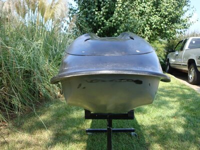

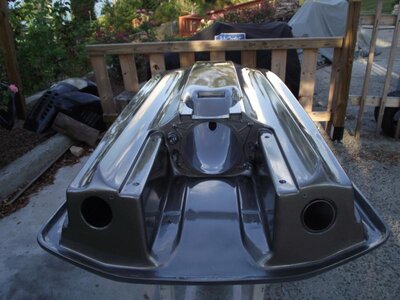

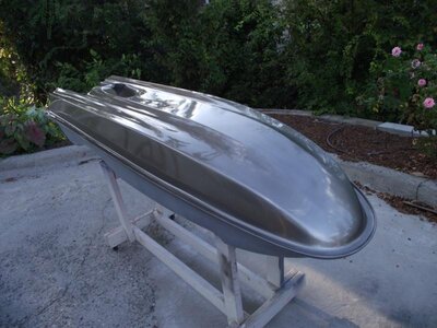

This past August Mcdog setup a nice little freeride where McBob got her cherry popped (or his balls busted) by some of the Florida boys...Berky, Jetmaniac, Aircraftsalz, Lucaumpits, Crashnburn, Blue...forget whoelse came up. There were 3 Superfreaks. I got to ride 2. I missed out on Lucas's ski due to wrenching (and being pissed at myself), but after that day I was hooked on how I was loving the ride of the Superfreak hull. So, I called up Berky a few days later and put my order down on a glass 'Freak.
Tem/Berky was fantastic to work with as a builder. I was a bit apprehensive, but Tem's easy going disposition and willingness to answer questions made it a whole lot less stressful than I imagined. It took about 5 weeks from order to delivery and nearly 5 days of that was a botched shipping order. I got my hull this past Tuesday (9/21). Hull weight with scupper tube, exhuast tube, battery tray, and nose piece was 77.5 lbs. Tem made up a carbon/glass hood to go with it 7.5lbs for grand total of 85lbs. It's a bit heavier than the carbon, but my wallet is alot happier I made the glass choice.

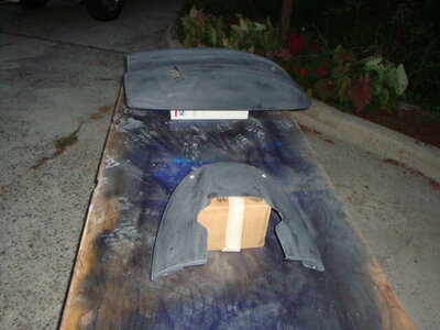

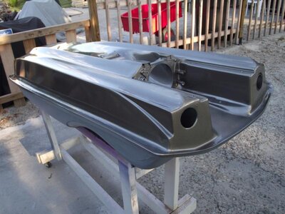

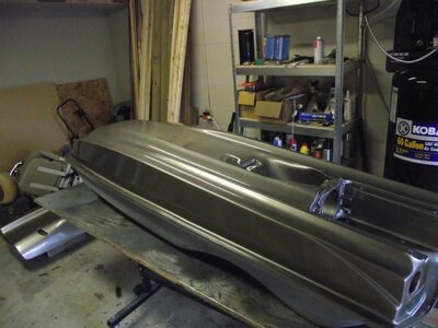

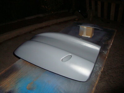

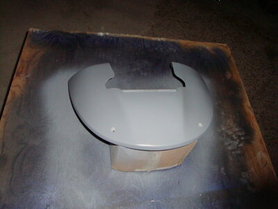

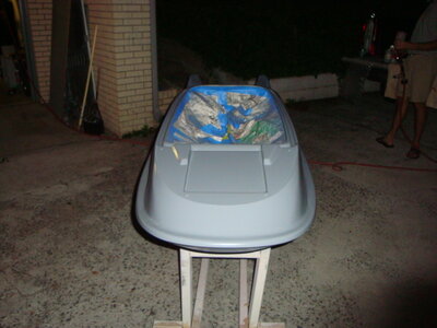

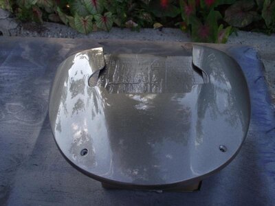

I got to work pretty quick on Tuesday. Got the whole hull, hood, and nose sanded down with 100 and 150 and then gave it a nice bath with H2O and some acetone. I took it over to my boy Waternuts house for some primer action. Again (I'll be saying this alot) Tem was great. Instead of me having to go buy a $50 quart/can of epoxy primer Tem gave it to me for free...it was even garlic flavored (see pic). Waternut and I mixed it 1:1 and shot it on there nice and thick. John/Waternut dose a nice job with a spray gun

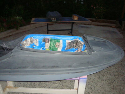

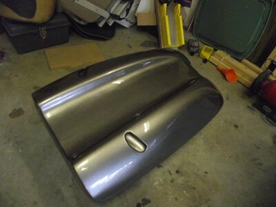

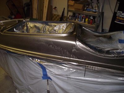

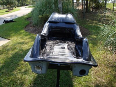

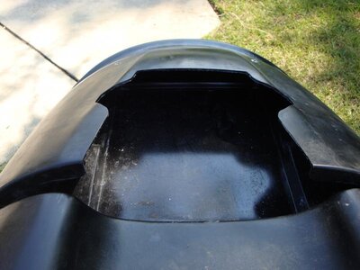

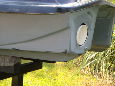

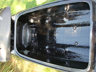

I took it home from John's that night (9/22) let it dry and attacked it with sandpaper on 9/23. I worked it over with the sander and my hands. Gave it another bath and prep'd for paint Thursday evening. Got my paint from TPC global. It's a single stage enamel. Dark pewter firemist is the color. Waternut handled the gun once again. I think we got a total of 4 coats on it. Planning on giving it 24 hours dry time...with some baking time in the sun today. Trying to get out there this evening and get the top deck painted. I'm happy with how it turned out.

I'll attach some bigger pics. Not sure sure what happens to pablo's. I jacked up the top deck tonight on the last coat and it got some heavy runs. I'm blaming it on the gun since half the air passages had gotten clogged up and it was spitting and sputtering. I attacked the gun afterwards and got it cleaned out but we lost a day.
