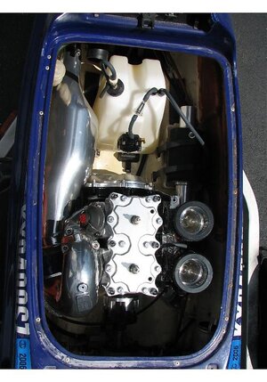

No! it's just polished like my handlebars,turnplate and flywheel cover. It only took him 2 hours and it looks like it was just chromed!:bigeyes: I personally wouldn't trust getting a cylinder jet coated
BTW that cylinder will be sitting on a nice little 10mm!!:cool2: :woot:

Nice!! I went over my cylinder w/ various grits of sand paper to remove casting marks and just clean it up. The polishing looks awesome. Jet-hot would look nice but I agree that it is risky on a cylinder. Plus want to cylinder to radiate and disipate the heat, not hold it in.

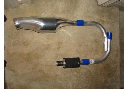

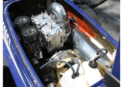

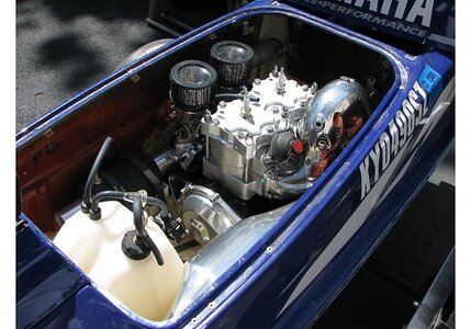

I am going to test this modification further but the theroy is promising. I like to run a hot exhaust system but am always affraid of melting a hose here or there. Like wise I don't like the number of bends that the exhaust makes between the end of the expansion chamber and the outlet on the waterbox. To many in a short length. In addition to that, I don't care for the 2in od of the expansion chamber opening up into a 2.5in waterbox inlet............increasing pipe diameter should decrese velocity.........then you injetct water into the exhaust, which decreases the exhaust temp, further slowing down the flow. This modification should keep the flow velocity up, decrease the number of bends and allow you to run hotter exhaust temps w/o fear of a meltdown.
I am going to start by using a PJS waterbox (loud) while I am waiting on my X-metal waterbox to get back from the welder. For the x-jet I am not going to have the battery mounted in the OEM location. Instead it will be mounted in the bulkhead. If this proves to be too nose light, I will have enough room to mount the battery in the OEM waterbox location, so I will have room for further balencing the ski. This will also allow for easy battery maintance as the kart gas tank can be removed quickly.
Mandrel Bends
The way current exhausts are set up is they make a 45 degree into the waterbox, then a sharp 90 up, the a anouther sharp 90 to the front and/or back, and then out the rear of the ski. On this exhaust it will have 2 90 degree bends at the front but they will be swept on a 6in radius via a 2in pipe, then into the waterbox where it will exit a 45 degree transition (2.0 to 2.25) and meet anouther 45 degree transition coupler (2.25 to 2.5) where it will attach to the exhaust tube that exits to the rear of the ski. Essentially all I am doing to smoothing out the flow and keeping the velocity up.

Nice work… I think this setup would scream on the top end but I'm not sure it would keep the water out of the chamber when doing freestyle stunts. If this works you should sell this as a kit and who cares about how much noise it's going to make?
What's the inside of that PJS waterbox look like and how well does it keep the water out of the chamber?

I am doing some cool mods to the X-metal box that will allow it to do in place of the PJS box. I am also going to test to see if perhaps a 2.25in pipe yeilds better performance. As far as the water running back into the chamber, if you are running a pretty dry exhaust and water is injected into the waterbox directly you should still keep the bulk of the water in that location. The way I see it you might be able to get away with not running water to the pisser and just inject it into the waterbox. The bends will be ceramic coated as well and that will allow for those hotter temps to be run. I have anouther little trick that I will not reveal yet that will virtuall eliminate all exposure of the silicone to the hot exhaust........so you will not have to worry about melting a hose! The new inlet on the x-metal box will have a 1.25in lip around it on the inside and be mounted high to prevent back flow.

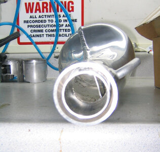

Have you seen the top secret :sneaky: Team Scream limited pipe modification that chuck's using on his skis? He uses a different diameter exhaust outlet and welds a shield around it to keep the water from coming back into the chamber. It looks like a great idea and it uses the same 2-1/4" outside diameter hose as the stock waterbox.
I might be running something like this soon, with a custom water box and aluminum tubing.

Team Scream are some smart guys w/ great power making tips and tricks. I have not seen their mods and don't want to copy their stuff. The way I want to set it up the mandrel bends will essentially be a extension of the expansion chamber and water will be injected into the waterbox after the fact. Maybe if this tests well I can see if we can work something out with X-metal and Team Scream for a production run on this idea.......thats justa hypothetical though.
