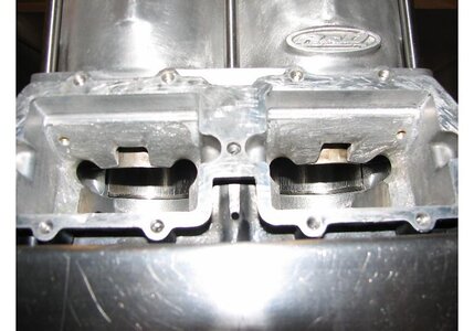

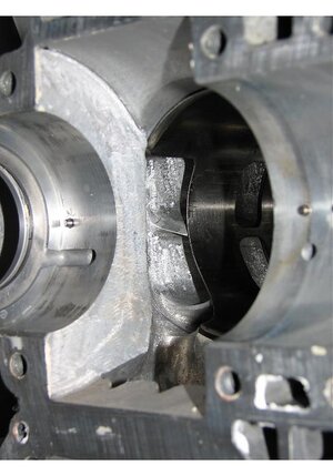

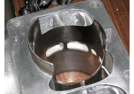

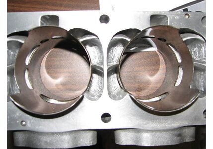

Transfer ports roughed up on the lamey. they were perfectly smooth before w/ casting marks left on them. No reshaping, just ruffed. A buddy of mine is going to put a fresh one on the cylinders for me. I have one season left on them before re-sleeveing.

maybe :sneaky: :ugh2: I will have some pics of other stuff as well shortly. MSD ignition wired and manifold mods done and mocked up. Getting ready to send more parts out to be coated so hopefully the longblock will be fully assembled within the next week. I am surprised no one noticed how smooth that lamey cylinder looked in the pics above :biggrin:
IceRocket1286
Metro Detroit
what do you mean you have one season left before re-sleeving? Do you freshen it up every season? Cuz it should last alot longer than that, as long as there are no uh-oh's.
RiverRat
Louisville, Ky
Those sleeves are just really thin and I plan to ride allot this year so even if they get scored lightly, there is not more room to overbore them. Luckily they are good and clean still, no scoring so I should say I am good for at least anouther solid season w/o incident. If there are any mishaps they will have to be re-sleeved.
