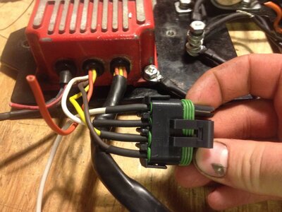

Soldered and crimped a waterproof GM OEM Connector on the MSD brain.. need to do the coil side later this week.
Dont mind the split in my nail in last pic, some hotty came into the shop so i gawked and hit it. Fckin hammers. :D:p
