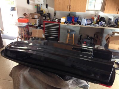

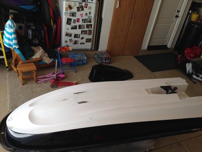

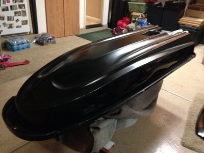

Okay finally back on this build. After waiting two months on the paint, I had to gelcoat the bottom
Because it reminded too much like an Orca......

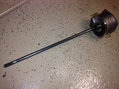

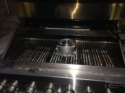

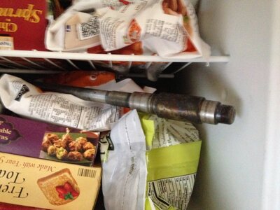

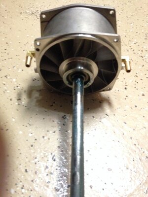

So I put the pump together using the freeze and heat method since I don't have a press to stamp in the bearings.

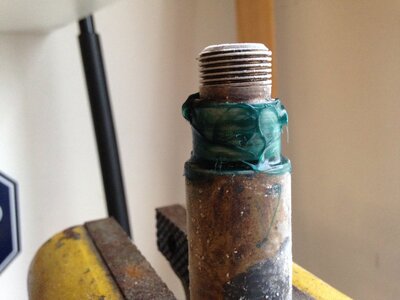

First, I took the drive shaft out of the freezer and put some marine grease on the end.

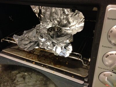

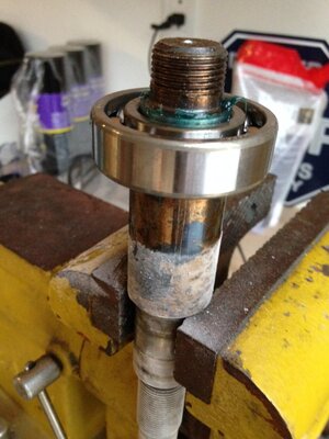

Next I took the bearing out of the convection oven at 250 degrees
Hot bearing slides right onto cold driveshaft. Notice the heat transfer from the bearing thawing the top portion of the shaft. Return the drive shaft and newly installed bearing back into the freezer.
ItsRixter
SoCal Wav Jumping shiznit
Sunny Diego

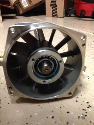

Now take the frozen driveshaft/ bearing assembly and place some grease on the outside portion of the bearing. Dump a bunch of marine grease into the hot drive shaft assembly. Push in the two front seals into the housing. Now slide the driveshaft into the housing.
I did this on a vice so it was holding the pump but allowed a driveshaft to drop in. It also allowed me to once again use a socket to tap in the driveshaft assembly all the way to seated position.

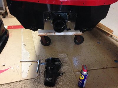

I'm having an issue with aligning the pump. I finally took off the pro-tec drop nozzle setup and just put on the stock nozzle and steering and it aligned near perfect.
I used shims on the pro-tec setup, but couldn't get it centered. Since I'm using a solas mag pump, I didn't want any alignment issue to negatively effect the bearings.
Any of you out there have experience with the pro-tec setup and alignment?photo 13.JPG
