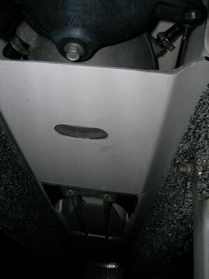

the ride plate does not need to be ground down it needs a hole cut in it to clear the "seem" where the reduction nozzle and stator section meet.
i thought jeff did this on the plates before shipping, maybe he neglected to cut the hole on a few...?
and yes the "cracks" on the nose are deffanitly not cracks in your hull they are a transfer from the bottom deck mold.
i had to use a thrust steering cable and SN throttle cable a tandem bike cable is long enough fro the trim.
this may be due to routing the cables around the WDK pipe, my RRP pole was also fully extended when i assembled it.

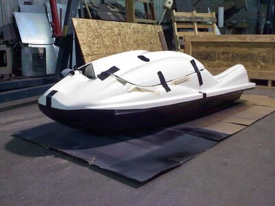

i want to see some pics of some roks
here you go
attachment.php
sjetrider
I aint got a fully assembled pic of mine LOL, all kinds of build pics then never took another.
We have 2 more here now, a black and a white, Toby gonna be a busy mfr for a while.
Even Walker is talking about getting a hull now......... Looks like I gonna be the broke guy riding the last of the OEM Hulls!
