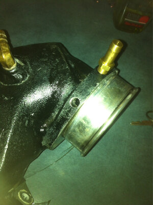

The water jacket shouldn't extend into the area. Are you sure you didn't just drill into a gas void/porosity in the casting?
If the manifold is not currently bolted to a cylinder, use a short section of hose to connect the two cooling inlet ports together to block them off and fill the water jacket with water through the holes in the cylinder mounting face.
Same thing happened to me. That area is not solid by any means. The water jacket extends further into that thick boss are than everyone thinks.
The one without the fitting definitely went into the water jacket.
XFS has heaps of room for the second fitting.
Just plug welded the inside of the first hole and screwed a bung in the top, not a major stuff up.
