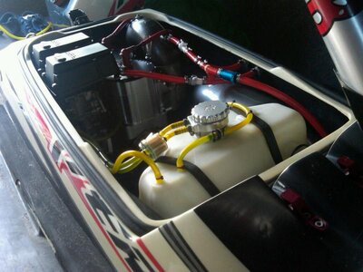

Rickter got some PreDaytona love. Installed the replacement XS waterbox, and have a brand new battery going in. 32days from now be on the road for FLA!!! Cant wait I need a vacation.
