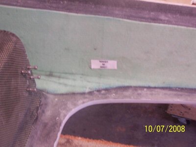

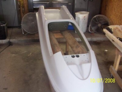

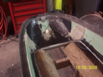

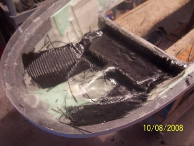

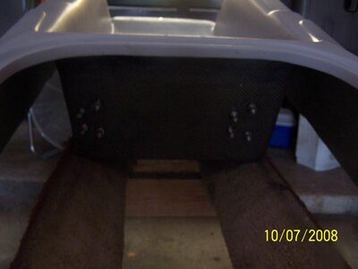

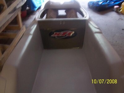

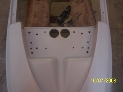

Finally got the rest of my XFT parts including the topdeck and nose mold. I went ahead and fit the nose mold with the topdeck laying on. I was told to use about five layers of biaxial on the mold. I decided to go with 2 biaxial and about four carbon fiber. I reinforced a few areas in the front topdeck including the handpole area with carbon fiber. It is amazing how light this topdeck is. I would guess after the few reinforcements that it will be no more then 13lbs. I weighed the bottom deck with a layer of carbon fiber on the bottom Tubbies, exhaust , scupper and strap hardware installed at about 62 lbs. I am hoping to be at 85lbs with footholds, 2lb foam and innerwall reinforcements,(HOPING!)
