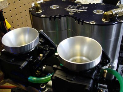

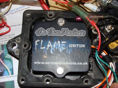

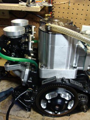

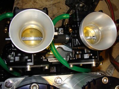

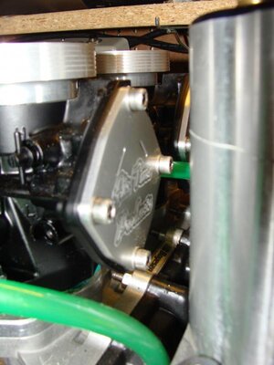

Fitted my dual ATP 48mm Carbs and Started fitting the FLAME

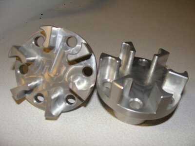

Did a mock up on the pole too....
just waiting on my pole bushes to be turned down to size (hint hint doug) then i can start assembling, with the location of the pole bracket i need to put the pole on before i can assemble waterbox

The Carbs are a true freestyle carb, annular discharge 48mm, uses a 44mm inner ventura and a 48mm throttle valve which gives increased pulse signal for low end snap!
I cant wait to run them with the SS motor

Chris has been having some issues with carbs from Mikuni, apparently they have changed the internal design, so im lucky to have this set, the way he jets them there should be minimal tuning

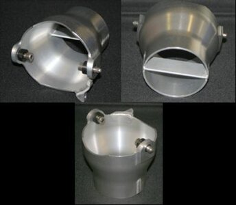

heres a pic of the turn nozzle

did a couple things tonight, put on hood straps, they ended up fitting great under the hood latch system bar and the front then i picked up on the e-box bracket bolts
bonus was this meant i had the stainless bolts spare that i could use on a D Ring which is now mounted at the front for towing/strapping
i did discover another "Jeff-ity" .......... the stock RN exhaust hose isnt long enough for this hull... by approx 2" so i guess its plan B!
Drilled and tapped the holes for the intake grate, thats now fitted!
trying not to go too crazy here and keep my slow pace up!
