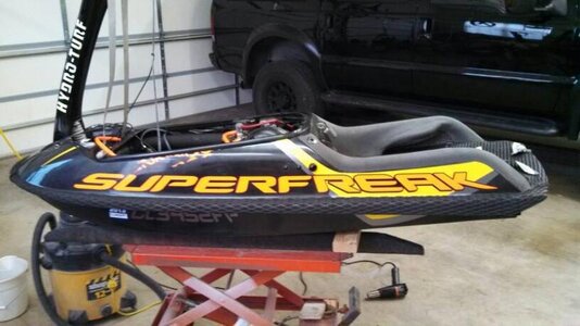

Figured I'd bump this old thread back up by sharing this absolute gem of superfreak knowledge:
Always work on a freak with the nose down. Best chance for recovering anything you drop! Especially when you have all the total-loss stuff crammed in the back!!!
You're welcome. :D
Sent from my XT907 using Tapatalk 2

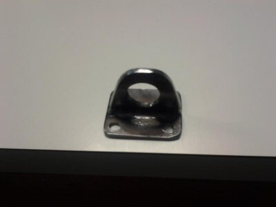

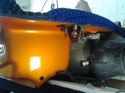

Was wondering what you guys do for towing with superfreak,can you drill and put a bow eye in the thin bond line on the rear of these carbon hulls? also,im getting a little water in the back of hull,since no foam is used,someone made me aware of little mini versa plugs that are used in rc boats,was wondering if putting them in would be a surf issue,If the ski gets away and is upside down,will air escape from the rear tray pocket and allow water in? There are chambers in the rear so im thinking not,might be better if it lets all the water out the rear during the ride to lessen chances of it sinking if it gets away and upside down?
