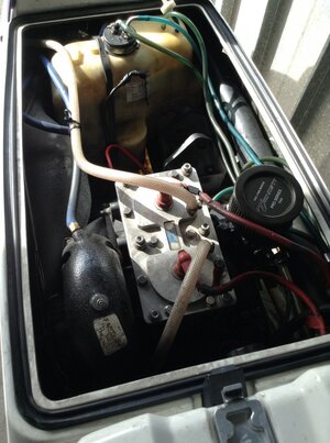

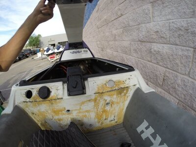

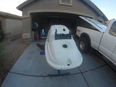

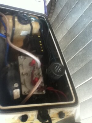

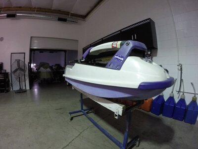

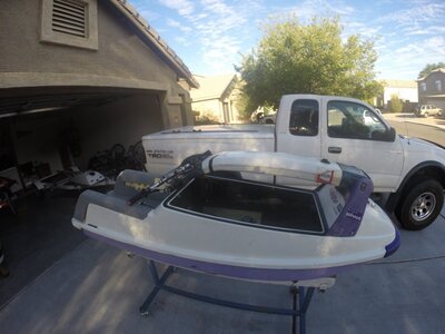

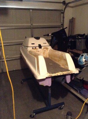

Got a few minor goodies, haven't had much ride time since the footstrap install but hoping to start going big here soon. The ski has more than enough power for me now, wide tray is next.

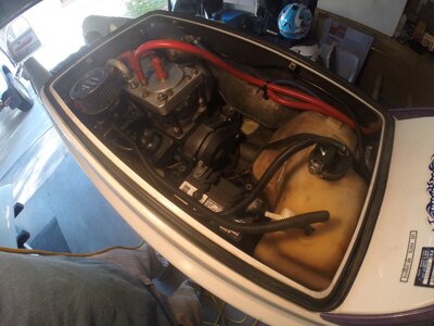

As it sits,

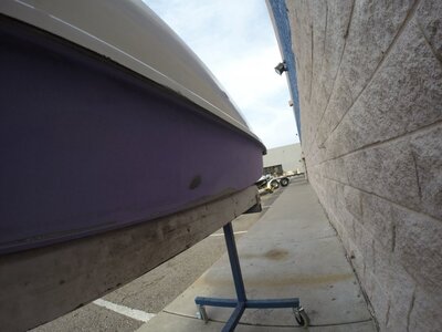

Stock hull

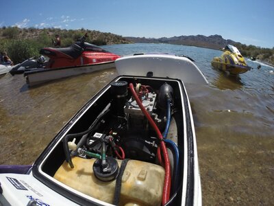

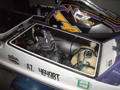

61x/61x 701 stock bore

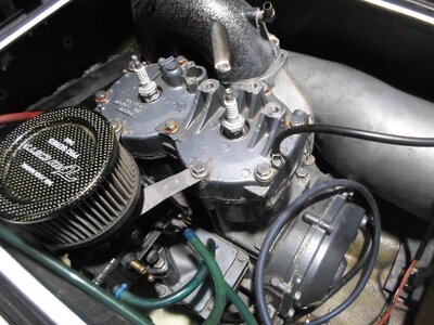

Twist 701 girdled head
Tau Ceti flame arrestor carbon
Single 44mm carb b pipe jetting except 140 main instead of 135
Factory B pipe exhaust system with fx1 manifold and head pipe and superjet limited chamber
Stock pump and prop with visibility stream and all
Rule 500 bilge
RN superjet water box (biggest pain in the ass to fit!)

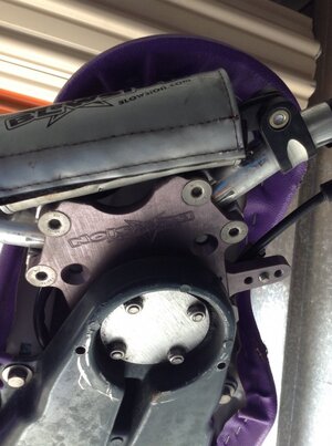

Blowsion steering system
Blowsion straight bars
Odi lockons
Hydroturf
Dakine footstrap

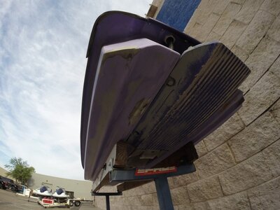

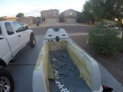

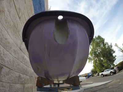

I absolutely love the ski, I think I might want to shorten the pole soon but I know I want to wide tray it. I'm thinking -4 on the pole and I'll be doing the tray as wide as possible.
