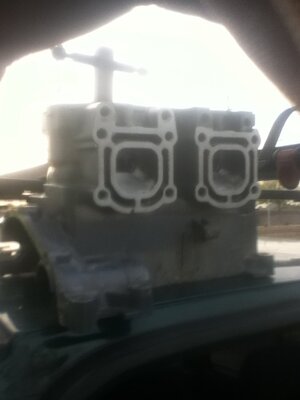

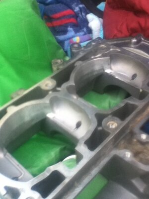

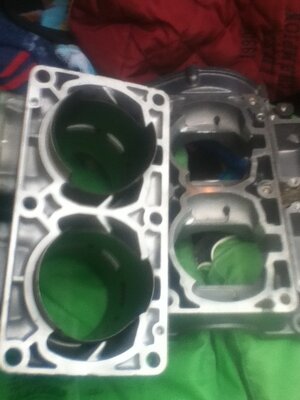

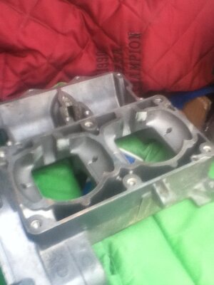

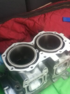

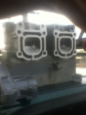

yea i was ready to sit this weekend out but i can make it happen. haha always a good time riding with you guys ill try and get there on time haha. i pulled the plugs opened the gap a tad and then she revs right up. i need a girdle kit and ill be able to install this high comp head i have. My fx gets like no water inside the engine compartment even after stabs and power subs and such. its soooo sealed i keep not putting a bilge on, but i just siliconed the tray in for the bilge and ill run my handle bar switch. i got the new thrust water bypass (2 of them) and the thrust bilge outlet. they look super slick i cant wait to install them haha.
beautiful did you b pipe it too? i just got back from APS and my motor came out fresh!!!! he did exactly what i asked plus decked the head surface and decked where the cylinder meets the cases. did exactly what lamar said to do with the cases i guess i should get an aluminum .020 spacer plate and she will RIPPPPP!
So you had him deck the cases? nice man..that is the way to go man. The spacer plate....for what? the top of the cylinder?
I didn't realize you were having all this done.
bottom. but i dont need one now that i just realized haha. i gave him the motor to do the bore and hone to 84.5mm and then open up the cases to accept the 760 sleeves for a reasonable $225..... when i got there he decked the surface .20 on the cases and he decked the head surface. im super lucky and im definitely grateful of steve. he also guided me on how to clean up the ports safely to get alittle better flow out of the motor. just pointed out the burrs and imperfections that can be touched up to make it that much better. Did i get lucky or what!!! if he had ported the intake and exhaust while he was at it i would have had to wake up from dreamland haha!
Literally made that old cylinder look brand new. Cleaned up every contact surface, my iPod sucks but in person it looks amazing. Jason remembers what they looked like, night and day!
