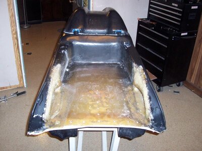

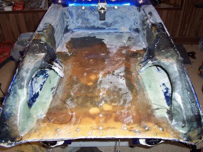

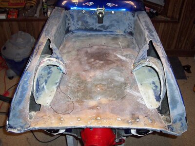

Well I finally ditched the highroller holds. 1st pic is the hull with the highroller holds, 2nd pic is my heavily modified XFT holds with huge gaps, and the last pic is all glassed in. Tomorrow, I'll move onto padding and turf. It took me two days to glass because I needed to make sure the first layers that were stretched across the gaps were solid before moving on.

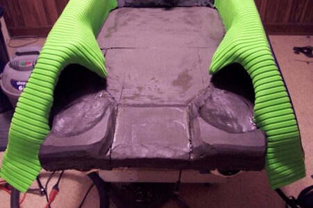

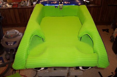

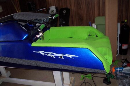

Finished pics of the new turf and massive kick tail to hopefully keep me from sliding backwards and my feet in the holds. There are 3 layers of 3/4" of padding in the back and roughly 1" under my feet and 1/3" on the top of the holds. We'll see how it does later this afternoon...

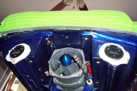

did you wrap the turf under at the rear? If so, the water is going to rip the turf off, possibly causing it to rip up into the tray. Might want to trim it at the edge. Sand with a sanding block at a 45 degree angle to the ground.

Yes I do have a metal strip on the back edge to prevent the turf from pulling up. Here is the side shot as well. As you can see, I haven't changed the chin pad or the side rails. I'm pretty sure I have enough to do at least the side rails but since the ones on there are holding up great, I'm not going to ruin a good thing just yet.
