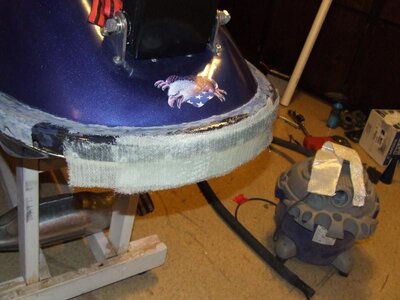

The lip is made of 2 layers of 8oz biax. It's strong but I am a little worried that someone will eventually grab that lip like a bond line and yank the ski up on land or something. It might hold up but I kind of doubt it. This pic is before I trimmed it.

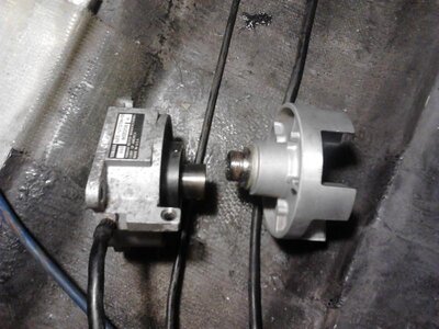

Finally got the gp800 midshaft. I noticed two immediate problems. First, when trying to remove the coupler, I ended up unscrewed the splines from the shaft coupler...didn't know such a thing existed. Second, the splines on the midshaft don't start until the threaded section that I just unscrewed which means the driveshaft won't actually touch the midshaft splines. Not sure how highroller got around this unless he moved the bulkhead backwards but the pic that chips sent me a long time ago makes the bulkhead look like it's in the same place. I sent chips a pm about it in hopes he can help.

Well I'm thinking chips has a gp760 midshaft as they are the only ones (that I've seen) that are this short and don't have the shaft coupler. I did manage to snag one this evening but I'm kind of thinking of just bolting it all back together with the SJ shaft for now and riding for a while before I slap the new midshaft in. I guess it'll depend on when it ships really...

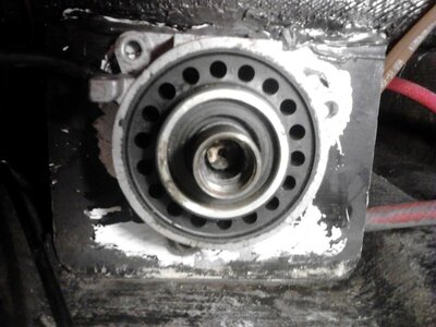

So you have my attention on this now.l have a fx1 midshaft bearing laying around here somewhere.But that means drilling and tapping new holes in the plates! Oh Boy! That sounds like a blast.....You guys think it will make that much of a diff?

Don, the bearing housing is the same size between '94-up SJ's, GP760, and FX-1's.

I think Don is referring to actually drilling and tapping the engine mounting plates.

And yes,l meant like waternut said actually drilling and tapping new holes in the engine mounting plates. but if makes that much of a diff,then it would be worth the effort.Being able to go faster than just above idle.That seems like an interesting concept.l would actually be able to chase a boat down.

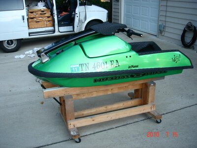

Anyone figure out how to put a bow strap on these hulls yet? The only thing I can think of is to mount some kind of U bolt on the front but that just seems like a blunt stake that could potentially hit me one day. My other thought was to mount a strap at the base of the pole but not sure how well the pole bracket would take the pulling loads.

Yeah that's kind of what I meant. I was really just thinking about putting one in the bond rail since it's strongest there. Yours is certainly in a better location though. I'll probably reinforce that area before I do that...which means pulling it out of the water. ugh

l did not reinforce mine.The piece l bought had a stainless plate on the inside and out.Of course l do have a sheet of 5.5 carbon in the engine bay.
