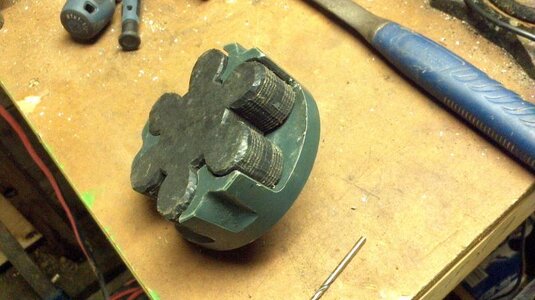

I blew my rubber coupler apart on a two day ride. Couldnt get another one so i laminated two pieces of a broken conveyor belt together then used a bandsaw to cut out the shape. I got to ride on day two! It had a bit of vibration but it worked.2011-11-08_20-23-43_26.jpg
