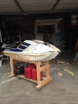

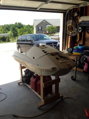

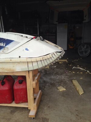

Good time to do a build and more then enough motivation. How do you plan on bringing the top deck down? Do you have a final weight in mind or just rock whatever you end up with?

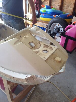

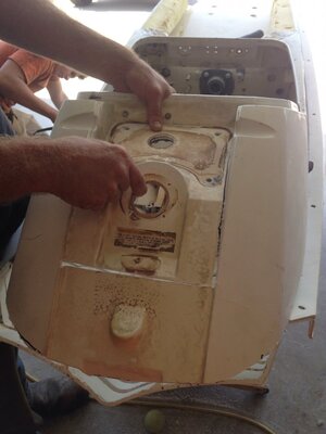

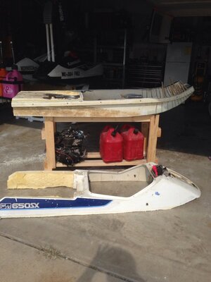

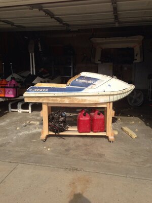

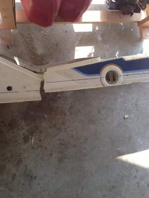

@iangdesign you a are right got plenty of motivation!! As for the top deck I just took a sawzall down the top of bond line and cut it off. Then measured 2in around the entire top deck and then cut that. I have no idea if that's the way you do it but that's the way I'm screwing it up.
Also by cutting the top deck in the front it actually moved the entire top deck forward 2in as well. I still think I'm gonna rework the pole bracket area and move it a little forward. I don't know what I'm doing so guidance is much appreciated.

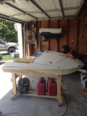

Well this is what I have before the heat and fiberglass dust got to me.
OOOOO .....YES HE DID CUT THAT TOP DECK OFF . I like the cut of your jib mister ! it takes me days to decide what direction i want go only to change my mind and go another.
Public service announcement No.1
Make sure your ebox,tank ,pipe etc will fit under the top deck before you make your hack. Moving the top deck forward makes more room for the pipe and tank but there is a limit . On a SJ with a B pipe you have about 3 inches MAX if you keep the same mounting points.
Dismissed .... Resume Hacking
Yep yep I have no idea if any things gonna fit but once you start cutting its hard to stop. If I threw a 650 back in it I know everything would fit I looked at my other one and have a ton of room. I think I'm gonna end up trying to make a water box and most likely get a kart tank.

Move the pole mount as far toward the nose as you can! Glad you hacked it down a couple inches...looks cleaner lower. The top deck compliments the rocker very nicely.

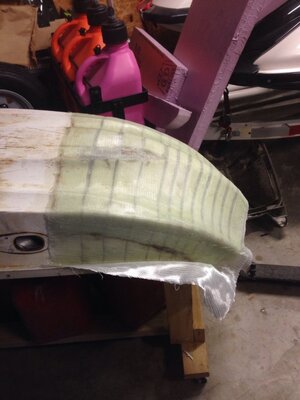

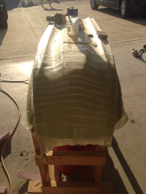

I would pick a heavy biax or triax fabric without mat backing. You make great points on the mat absorbing the surface anomalies and that its very thick which does allow for easy buildup of a very stiff laminate with good strength characteristics.
If the purpose of the build is to increase the ski's potential to it's maximum, why not take the time to add the couple extra layers of plain biax required to reach the same thickness. The result would be equally if not more stiff, far stronger, and marginally lighter.
Not that its a terrible choice...there's just better choices out there for not much more effort is all I'm saying.

Added bonus is the fabric should not really be any stiffer than an equivalent weight woven cloth. Everyone thinks biax is stiff and unconformable because they have mat stitched to the back of it.
Dalt, what would you recommend for reinforcing and redoing a tray for strength and weight savings? S-glass?
Wisconsin
Yeah I used a combination of s glass and triaxial to build the tray on my top deck. This glass is fantastic. http://thayercraft.com/9773.htm Very strong and being 8-Harness very conformable for it's weight. After having used up 30 yards of their 21.85oz I have no doubt about thayercraft's bullet proof claims.

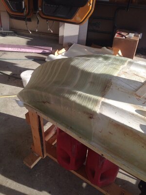

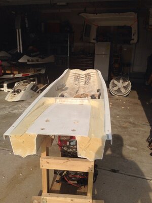

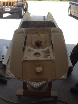

Well got my stuff today and I think things are gonna slow up some. Now comes the time consuming stuff.

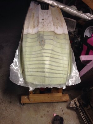

Also tubbies are a lot more difficult then I expected. I've got some rough shape ones made up but I'm not sure how tall I want them and idk how far from the bottom deck I should start them. What do you think?
