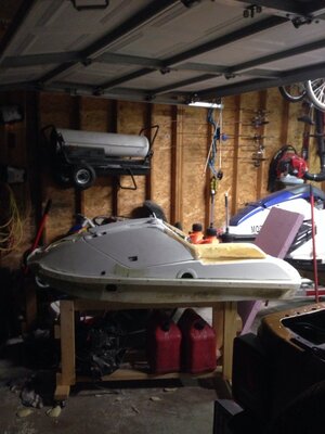

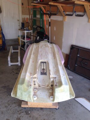

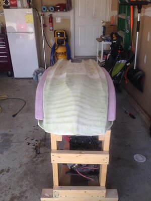

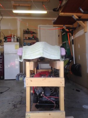

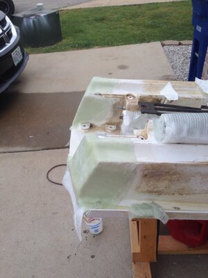

Well I wasn't planning on working on anything tonight but I saw some activity on the build so figured I had to keep you guys happy with some updates!!! I've been working a bunch so haven't had time to do anything lately.

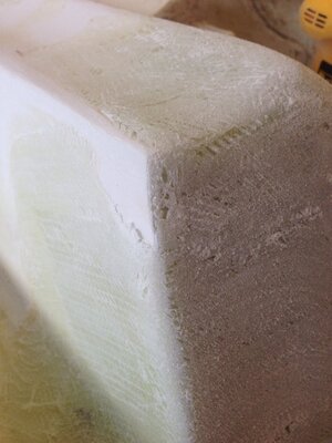

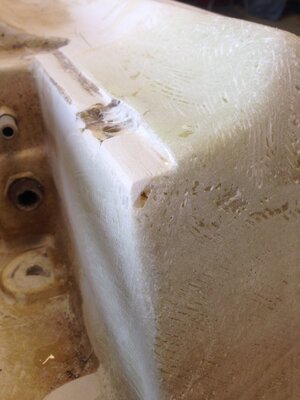

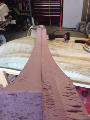

So I found out two things with the work I've done today. 1st is that builds happen in winter not due to having no ride time but due to being able to wear a hoodie and not get ridiculously itchy. 2nd is that with sanding my fiberglass inexperience really shines.
So I found out one thing if you wanna make smooth corners use an epoxy mix and not straight epoxy.

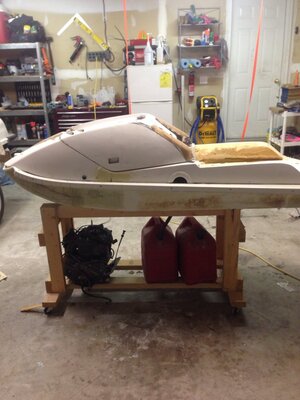

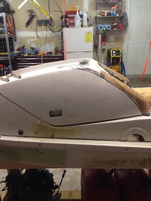

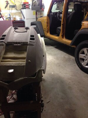

As for the hood I will absolutely cut out the liner because I think it weighs as much as my bottom deck but as for reshaping I think I'll just smooth out the lines and make it flow a little better. image.jpgimage.jpg image.jpg image.jpg image.jpg image.jpg image.jpg image.jpg

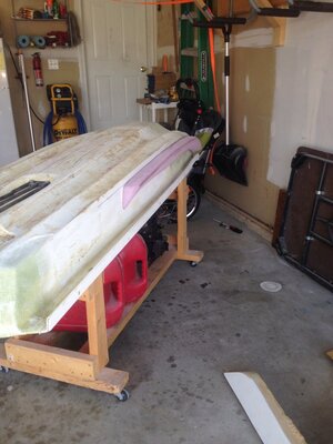

Going to try that with my spare hull, how did you separate the top deck? Just cut it at the bond line
Yep just took a sawzall and ran it on top of the bond line. Then took a speed square and measured 2in all the way around then went at it again with the sawzall. I'm sure there's a better more precise way but I was drinking and poop happens.

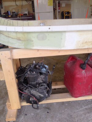

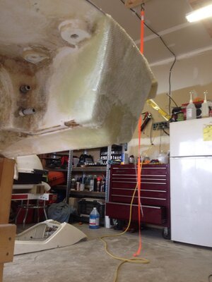

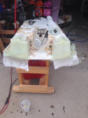

I agree the bottom deck is getting a little heavy if I had to guess around fifty pounds but I still have midshaft bearing and motor mounts in. Top deck I'm guessing weighs about twenty pounds at the moment and good is about 2ton. I'm hoping all sanded, body filled, and painted with the pole to be under 90 but will see. A lot of the excess bulk is getting sanded off which is a miserable process.

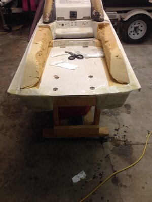

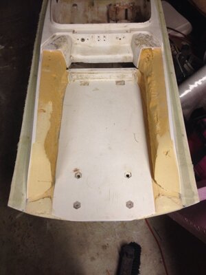

I think the bottom deck is almost complete just have to do tubbies then I'm done as far as fiberglass work and will move on to pole bracket. My xscream pole I wanted sold so I'm now up in the air on what pole and bracket to run. Any suggestions?
I don't think I wanna do tubes for this. I think a low pro pole would look slick on this.

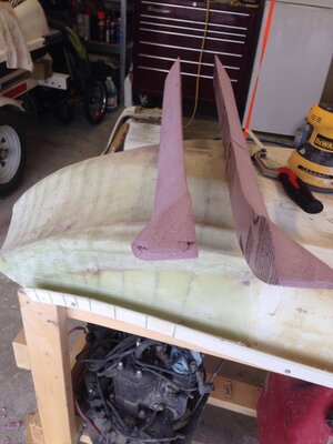

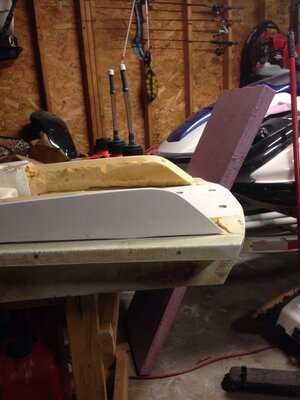

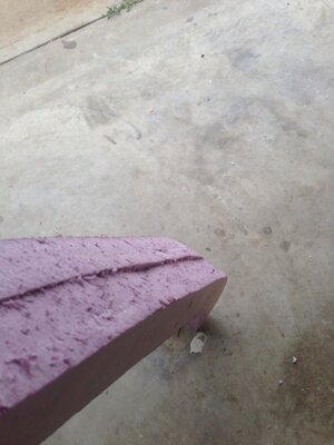

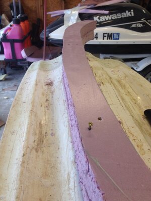

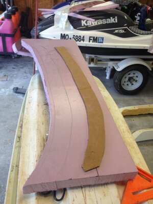

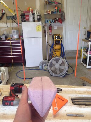

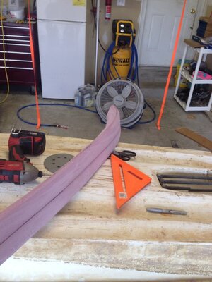

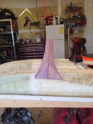

Anyways I ran out of resin so I decided to attempt my tubbies again and I finished them. All I used was a sharpie, razor blade, hack saw, speed square and a sander. Oh cardboard and deck screws as well.
