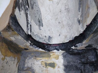

While I was at it and had everything mixed up I went ahead and glued up the reducer to the bulkhead , looks just like Cinnabon icing but not nearly as tasty.
Once it kicks I will sand it , probably glue it from the inside then put a few layers of glass on it , then we can see about glassing in the driveshaft tube once I have the pump positively located.
