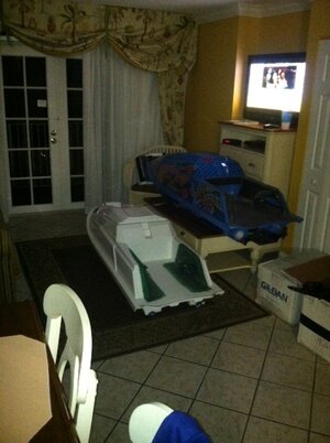

So…are you telling me my hull is not a virgin? :)
seriously though, thanks for keeping it safe! It would have been a drag getting it to my room in "the hood" motel next door
Yes, The we will stay open and charge full price during a major rebuild LaPlaya! What a dump...
