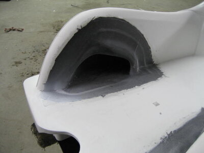

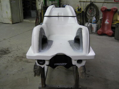

BTW what would you expect the weight to be if you had footholds and foam added?[/QUOTE The total weight after reinforcing the bond line with a carbon tape. Which is the whole front and behind the bulkhead while cutouts were open for foot holds. And the foot holds glued in and carbon taped. The hull weighed 77.8 lbs done. Then figure foam weight which I have ideas to replace that crap.

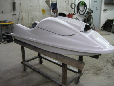

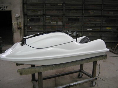

cant wait till friday I have everything ready to open box knife in hand ......except still waiting on factory pipe
ITS HERE........... just as I thought it would look like. very top notch work not a flaw in it, VERY light and VERY STRONG. will keep pics and weight posted as i finish the build....Very nice work Bobby
