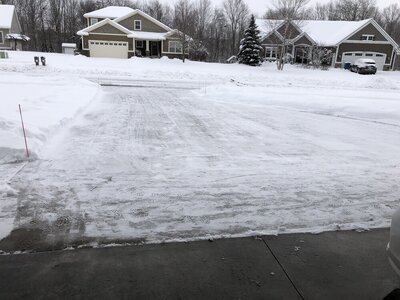

Had to clear my driveway 2x this morning already… I’d normally say moving south from Michigan sounds good, but I’m not sure how far down I’d have to go to get away from this stuff!

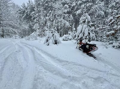

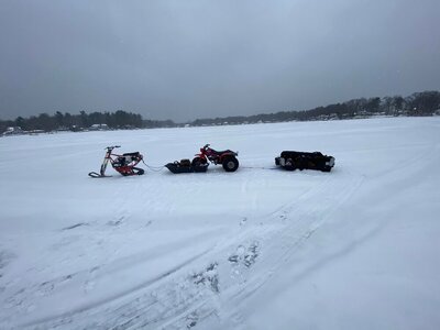

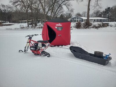

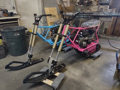

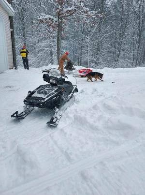

stock predator 212cc, comet torque converter. track and front ski off a artic cat zr120. Frame and suspension design by me. Only goes about 20mph, much torque is needed in the deep snow. Made a pattern and cast the front fork/ski bracket. Second gen stretched the frame and put more weight on the front ski. My first design is quite squirrely but fun. Finding small things to change and modify as it gets used. Only $1200 in parts and material. Best part it weighs 165 lbs so I can lift it onto my hitch hauler and take it wherever.

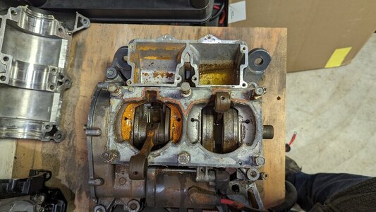

Working on this sadness during my lunch break. Every bearing is stuck
This is after dumping out what felt like half a gallon already.
I keep a 5 gallon bucket of diesel. Also my parts washer is diesel. When I get a stuck engine or cylinder. I drop the entire thing into the diesel. After 4 or 5 days. It's unstuck if it was from corrosion. Has never failed me yet. The diesel in my parts washer is probably 15 yrs old
