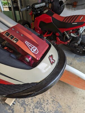

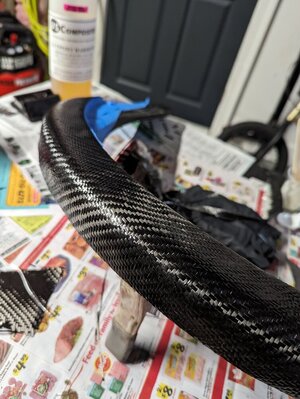

I had to reinforce and rebuild my splash guard so I tried my hand at visual carbon. Ended up adding 3 layers of 9oz E glass, one 9oz S glass and one 6oz carbon. I'm fairly happy with how it turned out, I'll give it a hot coat and a bit of clear and leave it exposed for now.

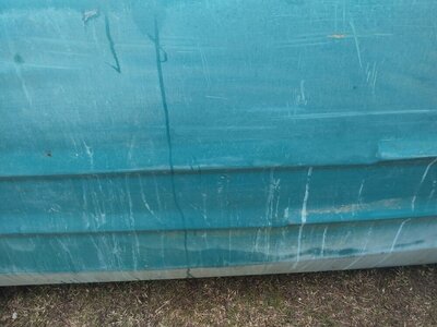

Putting some shiny back on the bottom , it's a sales boat so the scratches and damage stay. it just has to look good sitting on the trailer, the last time I did a complete bottom on a sale boat they ran in up on the rocks on the test ride, never again !
600 grit wetsand followed by buffing with heavy cut compound and then application of the secret sauce .
Thats a two corona job , it takes two coronas to complete the job and after two coronas it starts looking really good !
