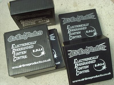

I don't wish to upset those who are disappointed but the contents of these boxes work just fine, and no, I do not get any royalties from anyone. This has been cost effective for me. I do like the performance of the Msd t/l system better (big spark) - have one- but I don't feel like paying that much money for a system for which I have to build a custom watertight enclosure that does not even use marine grade cabling. Afterall, I'm on water, not on dirt or hard surface.P1050368.JPG
I don't wish to upset those who are disappointed but the contents of these boxes work just fine, and no, I do not get any royalties from anyone. This has been cost effective for me. I do like the performance of the Msd t/l system better (big spark) - have one- but I don't feel like paying that much money for a system for which I have to build a custom watertight enclosure that does not even use marine grade cabling. Afterall, I'm on water, not on dirt or hard surface.View attachment 286618
