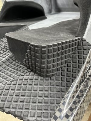

The one positive about the segmented turf was zero manipulation, heating or stretching was necessary for doing the foot holds. Pattern control let me wrap the irregular shape of the holds all the way around the hold.

Everything you see so far is from ONE sheet of waffle. I was getting scared so I bought another sheet, figured repairs should be easy to patch in, so it won't go to waste. This is all I had left of the first sheet...
...and I still have to make a hood pad ! Let's see if we can get it ! I get my 4 inch Hydroturf block out , and I find this. Hand ground it square with my 48"belt aluminum sanding plate.
So no problem , I'm good at making tank straps, (not by choice). I'll just use the Righetti! Nothing like swimming for shore, almost being there, and turning around to swim to the far side.
