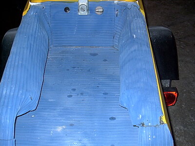

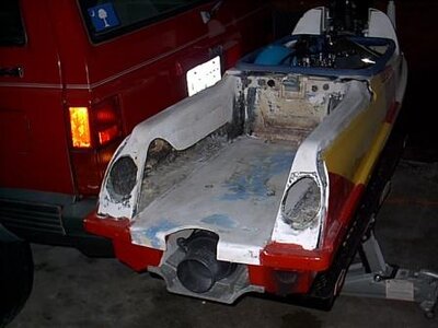

These pictures were taken during and after my idiotic custom footholds. All that open area in the tray was done with NO fiberglass. I glued the turf straight to the foam and ran like that all summer. Yes it was stupid...no the foam isn't wet. If you defoam the kawi stuff, you'll forever fight the yamaha battle of wetfoam.

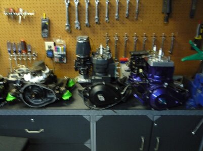

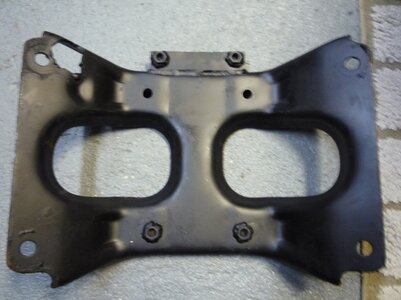

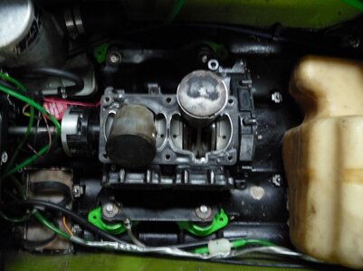

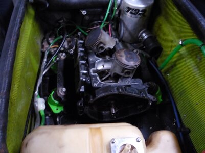

Here is a few pics of the bottom end sittin in there, the bed plate, and travis workbench. theres three motors on the bench, two on the floor, one 760 in the shed, one 750 bottom end, and plenty of extra parts laying around. (motor on bench with kawi bed plate is mine)
and i traded my 61x bottom end for one of travis 62t bottom ends so i will run the 62t with a 61x cylinder. which is suppose to be the best setup from what i hear..

NICE! I dig being able to use the stock bedplate. Not so sure about having to grind a hole in it so close to the motor mount though...seems like a potentially weak spot for a crack in the future. Could you weld up some kind of backing plate around it for strength? My computer doesn't zoom in too well, did you just weld a couple of nuts on the bed plate as spacers along with a small extension? Looking good so far!
N3vrSat1sfied
Military Member
Fort Worth, TX
ya i welded nuts on as spacers. Didnt have the holes drilled in that picture. The original holes in the back have to be welded shut and then the nuts welded on. I could put something behind it but the motor mount is still completly in tack so it should be alright.

Porting was always a pain because I was too cheap to buy the real nice porting bits and settled for other bits that took forever. I like that blue engine in the picture...looks nice.
N3vrSat1sfied
Military Member
Fort Worth, TX
blue engine is a 650 of travis'. i am getting there but having a few set backs the plate i made for the ebox needs some modification but i will work so i am getting there. My engine is ported and built
