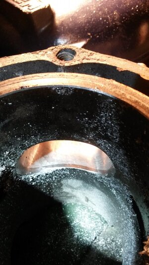

I use a 1/4" shank air grinder for the rough cut then a dremel with flex shaft for chamfering ports. The air grinder is a cheap-o but has worked for 10 years. Fastenal sells mini flap wheels with a 1/4" shank that are awesome for removing tool marks before you polish.
Google " 1/4" shank carbide bur "
Or " 1/4" shank flap wheel "
The dremel flex tool is on eBay for half the price and mine still works like a champ. I like the air grinder because you can stall it out vs. big electric grinders that will catch and do a loop around the port braking tools and scaring cylinder walls

What tools do you guys find best for chamfering the ports?
Ive ported my cylinders and just had it bored and now need to do the chamfering then I can build her up.
I use a flex shaft off eBay on my harbor freight dremel tool. Low rpm with a small ball stone making sure that I pay attention to the way the tool would jump if it were to catch. I would much rather it jump into the port than scratch my cylinder that I just had bored and honed. If time isn't an issue for you a "rat tail file" will also work. I have a file set where the entire file is shorter than a Bic pen. The files are very old so I don't have any advice on where to get them. Keep in mind I'm just a welder not an engine builder but it has worked great for me and I haven't had any issues with "catching a ring".
Uk
Cheers, I guess you meant a needle file. Found a really nice pear drop sort of shaped one. Took me best part of a couple of hours but all ports nicely chamfered now :)
Used an oil stone after to make sure it was all nice and smooth
