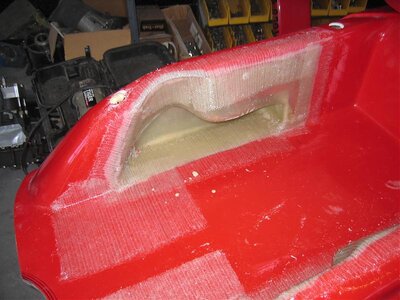

Rev footholds installed today.
foothold holes cut out. Foot holds are placed a couple inches forward to help improve my rolls. Reinforcment on the bond line layed in through the footholds holes. Foam poured to have a flat base for the footholds. footholds fitted (grind the lip off the bottom for best results). Glassed in place with extra glass where my feet usually are, still another layer to come in the bottom of the foothold. Holes in top are for final foaming
