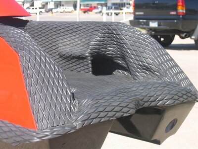

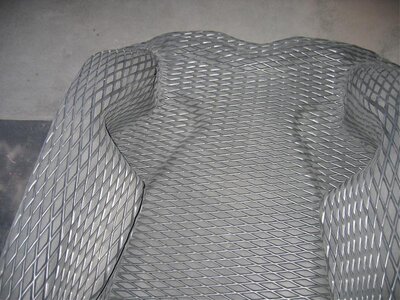

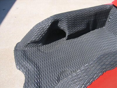

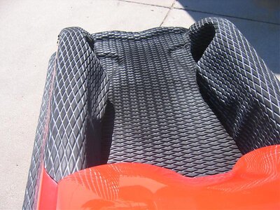

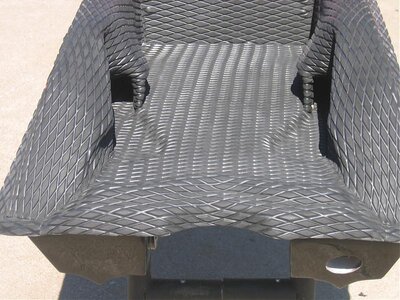

Turfing is done, it took over 8 hours for Chad and I to do this. Since the tray had extra room, we turfed in some subtle lifters in front and behind the footholds to see if they'll be helpful for riding out of the footholds. Side panels are one piece no seams. Nice think underpadding on the tray, in the footholds and shaped into a kick tail, tray is damn cushy. I broke a foot a few years ago, and prefer really soft turfing.

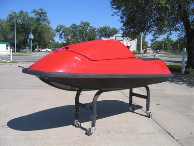

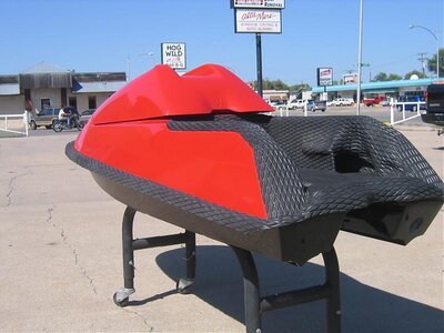

more pics, assembly starts tomorrow. I'm still waiting on some texilium, but I can install the pump, poles and lots of other odds and ends.
