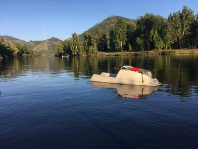

While project Yamasaki was patiently waiting for conversion parts, someone turned the thermostat up to 118 here in Idaho so I decided we needed to float now. Thought this ski came with a 550 pp, turns out it’s a 440.. perfect I love those little buggers. Even if it is a cruise ship bilge pump motor.
To make my RRP pole with Yamaha Superjet throttle cable and Yamaha start stop switch from a couch work I built a carb bracket from a motor mount shim. I then spliced the start stop switch in for some heavy YAMASAKI.
I learned the other day you need a steering cable extension to make an rrp pole work with a 550 cable.
But if you flip your pre 08 Superjet cable around backward the long pump part actually needs a bracket to mount it further down the pole to make it work. I hacked something together and she now turns bump to bump or almost.. would not say this is my final plan but it will get Yamasaki and I wet.
I’ll take some pics on the lake today
