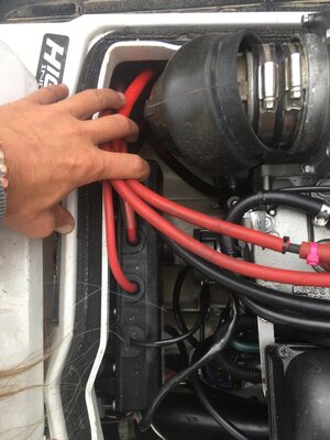

Has anyone run the breadbox pipe with this swap? Super close but hits ebox with it on that side. I flopped ebox mount but it looks like my battery won’t fit with it that way. Thoughts? Maybe cut down the bracket behind ebox mounting bracket? image.jpg
550headache
tobacco grower
tobacco valley
Sweet! I used a stock 650SX pipe with a factory pipe manifold works and fits well.
Make sure you give us a update as soon as you ride!
