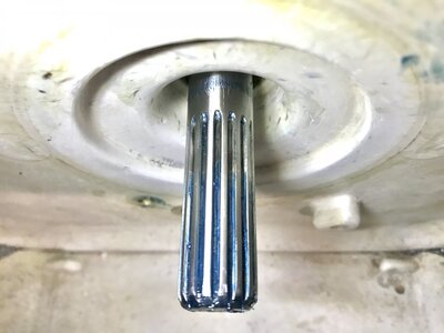

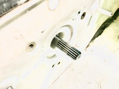

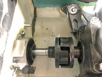

@JetManiac I’m doing my final checks on spline depth as you have suggested in the above post. My midshaft is set to 20mm, I have cleaned the grease from the driveshaft and put grease into the inner splines only. I installed the midshaft and have checked to see where the grease is pushed. It is making it about 2/3 to 3/4 of the way into the splines. I checked this measurement with calipers, the splines on the driveshaft measure to be right at 42mm and the grease is reaching to right at 32mm. I tried this test multiple times and came up with consistent results. I have 1 extra coupler washer that is about 3mm that I could push it back a little... what do you suggest? You mentioned something about 3/16” under lap, if I understand that correctly I should have about 6mm of space that the grease did not reach.
