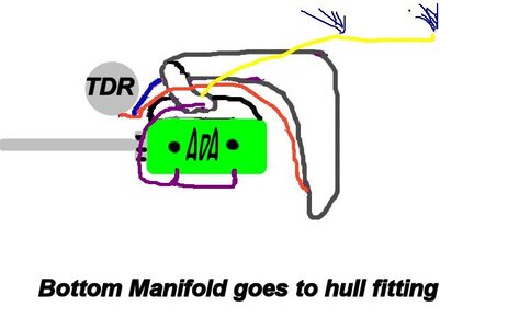

ya somehow i hooked up my water lines wrong to. I just looked at my Paint shop pro image and seen the cylinder head goes to the head pipe and the stinger goes to the water box. So i fixed that today.
Question... To avoid putting a ulgy flush kit by my head, (Even the quick disconnect would have to tee in) Can i back flush using the blowsion flush kit you stick into the pisser? or has anyone seen a INLINE quick disconnect flush kit?
-Travis has a blowsion back flush hose that he doesnt use in the garage now
The picture should help explain. My statement at the bottom simply means that the feed line of the pump goes into the bottom of exhaust mainfold ofcourse.

Holy crap those water lines look all messed up!

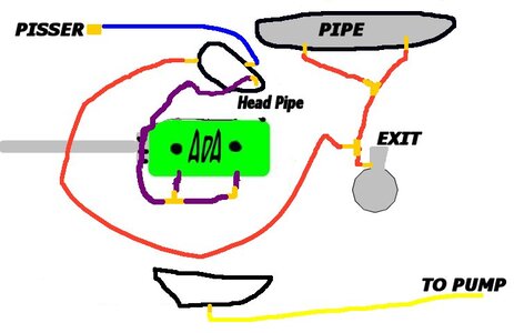

Either one of these should work much better... The first picture is how I have my kawi. The second picture shows what most people run but I've been told there isn't any difference.

i have three fittings on my head pipe.
What's the third one for? One in and one out... Unless you're talking about the stinger, what else could you need? Actually...looking at your pipe, it looks like you have 2 stingers...:261:

here check this one. I know it works cause i have ran it for some time the only diffrence is i have two head fittings now. but maybe it could work better i dont know.
yes i do have two stingers, pipe came that way.

Well if you only have one cooling line coming from the pump, just block off one of the fittings on the head. That will alleviate some of the clutter. Unless you're running dual cooling, you don't need dual outlets on the head.
I don't really know about that pipe setup... I started making recommendations but decided against posting them. Your best bet is to find someone who knows that pipe. I don't wanna overheat your motor or pipe based on my guesswork.
