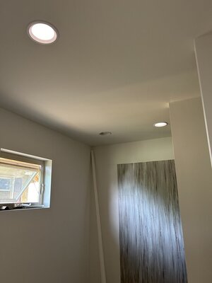

Passed my plumbing final a week ago, no issues.
Now coming to a close (one can only hope) by this friday. Attic insulation getting blown in today or tomorrow. That’s all l need to pass for a house final inspection. Then my C.O. (certificate of occupancy) comes next. Going to need a paved driveway to pass that one. But understand that l can post a bond and that will give me a short period of time to complete. But at least l can move in.
Most of the trim is done, as well as all the doors being hung. That’s a ton of work. All the trim is painted, but the knotty pine doors are not done as yet. Going to stain and clear them. The hall/laundry area is still a work in progress. Bk suggested some flip out shelving because of the small space, l agree.But that is something l can work on this fall. Got my old Bose sound system set up, as well as the tv. lf you look above the tv, you can see the plug in is a bit high. Can’t move it, but black friday sale ( bigger tv) will fix that issue ;)
