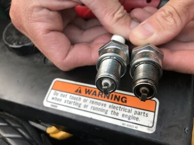

So having some issues. Rode great till last 10mins last night and then motor sounded like it dropped a octive. Much lower sound. Figured I just had water in my ear or something cause it still ran fine. Today took it out and it ran like poop. Felt like motor was about to die on anything less than 1/2 throttle. I usually cruse around at 1/8. Thought maybe plugs were fouled so swapped in new plugs. Same issue. Pulled plug and front cyl was soaked and plug still looked new pretty apparent it wasn’t firing. Got it home and tested spark and it’s firing just fine off water. Checked flywheel and stator and they still tight and dry. Checked ebox and it’s dry as can be and no pinched wires. Checked compression and it’s 175 a hole. No idea where to go from here. It runs good last 1/5 of my power band. Threw a backflip without issue which I don’t think I coulda done on one Cylinder. Feels like it running on one cyl (extra motor vibration) until that last bit of the power band and then it hits hard. But that front cyl spark plug looks brand new. We are stumped258F8579-F49A-4561-BD6C-3574C6A8DF12.jpeg
What did you find out? I’ve still got to find the time to pull this flywheel off and put the new on. Inquiring minds need to know!
Carb linkage adapter setscrew came loose and second carb butterfly was not opening properly. Was barely catching at about half throttle. Hence why it felt ok on the top end. Simple stupid fix.

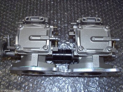

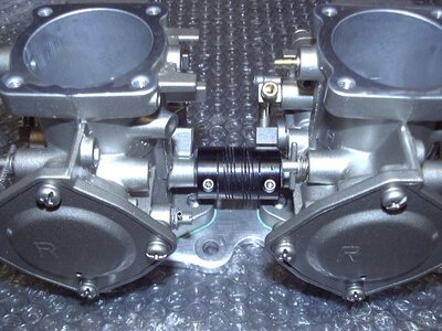

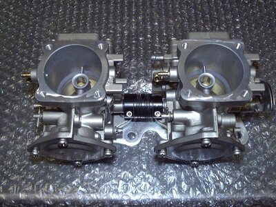

Don't know what kind of "carb linkage adapter" you're using- but expensive carbs deserve a decent clamping coupler.
