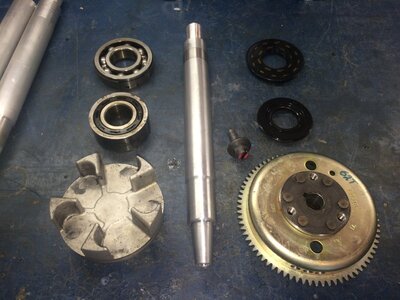

So the other day i borrowed some blown cases from my buddy Stefan, had and old OEM crank i cut the con rods off, now its ready to become bench tester. So now i just gotta talk the last details with Borut to be sure and get the right CDI box, adapt and electric motor with a speed control, before testing can begin :)
That actually looks pretty smooth but what RPM are you cranking that at in the video and high high do you plan to go?
The crank is balanced with the piston assembly intact and so cutting them off throws the whole thing out of balance. I know because I did the exact same thing when I build my test bench. Once you start putting some speed to it, the slight hop will become violent!
I ended up turning a dummy shaft for mine and am now smooth and balanced past 10,000 RPM.
I used aluminum initially with the intention of redoing it out of steel but it's standing up well so I will probably leave it.
